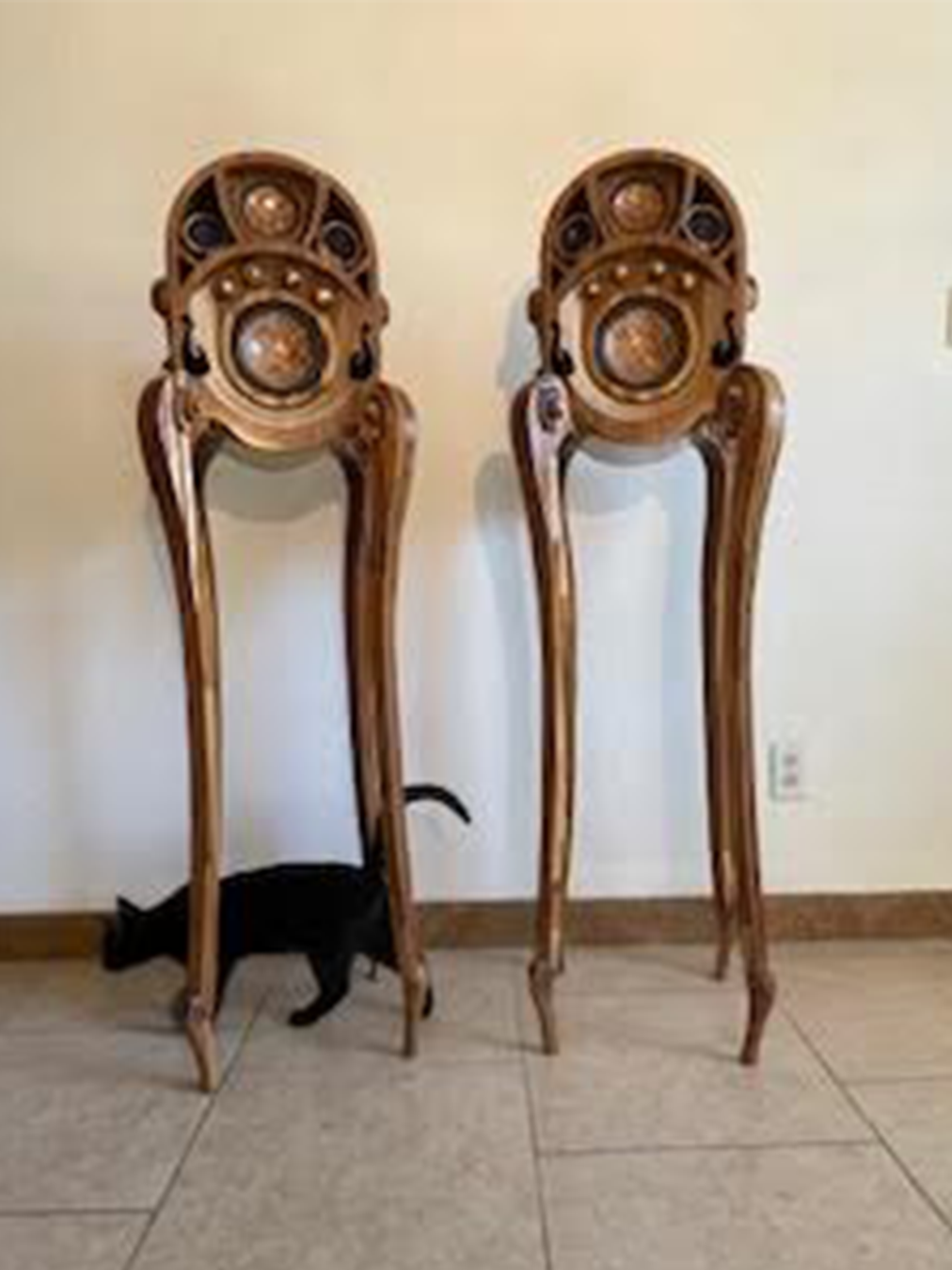

Pedestal style speaker. A smaller version of the Baroque Quintet, Quartet for a small room.
Design Goals:
To achieve the most bass possible from a 6.5 Subwoofer.
Driver Selection:
Modified Dayton subwoofer and midrange with a woven wood cones Home built high frequency and mid frequency tweeters
Enclosure Design:
Layered Asian hardwoods set in epoxy composites with hand carved Teak finish Tiger Eye stone volume knobs
Enclosure Assembly:
Designed from interior outward freeform construction with convergent helical port out through F holes
Crossover Design:
10 position rotary switch through autoformers and Dayton filters
