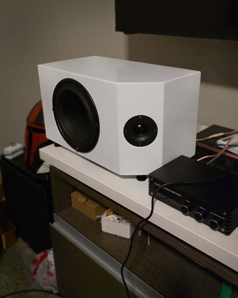

Project Description: Bookshelf speakers based off the Bose 201 and 301 with a few changes. I added a passive radiator at the bottom instead of a port and decided to go with the no grill option

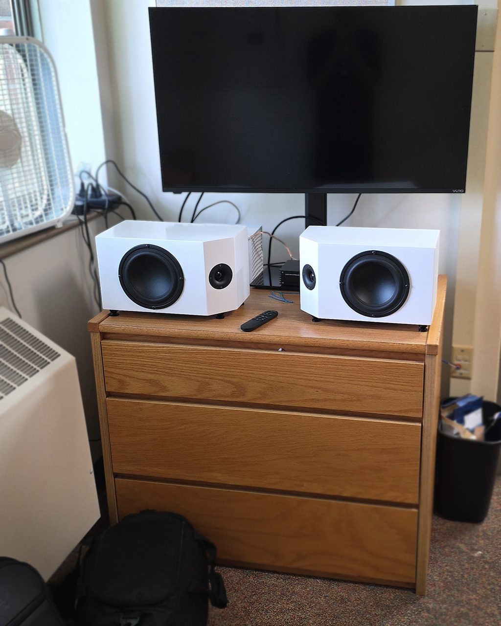

Design Goals:  Bookshelf speaker for my bedroom at home and for my dorm room at college. I am an incoming freshman at college, and I wanted some unique speakers that looked good and sounded good too. I wanted them to sound good without having to add a subwoofer for the sake of being in a dorm room and not disturbing others around me.

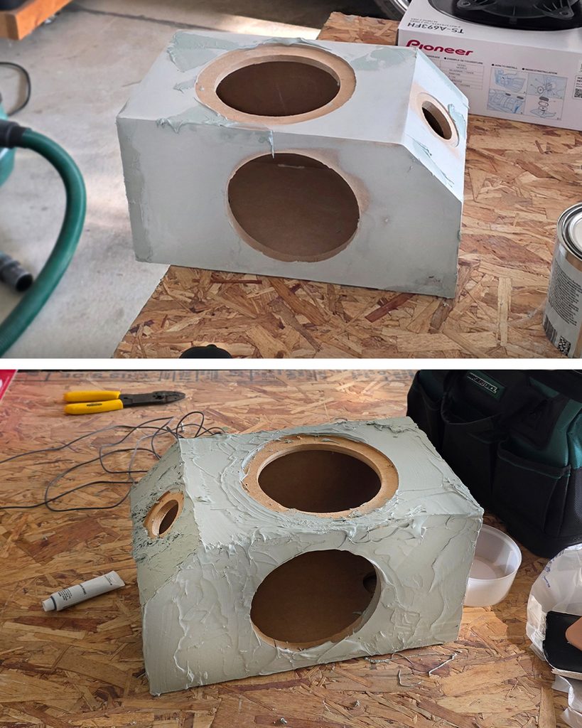

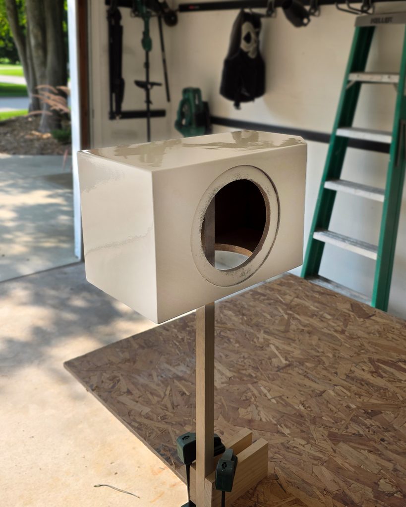

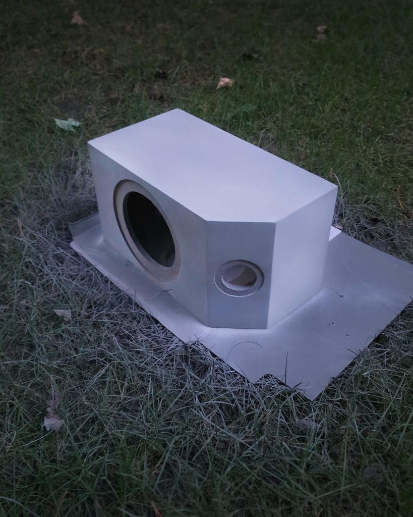

Enclosure Assembly: The enclosure is built out of 1/2 inch mdf board. The pieces were cut out on a CNC machine and are held together with wood glue. Then I covered them with a thin layer of Bondo and sanded that down to get a smooth finish. After that I primed them and then sprayed them with a white epoxy for a high-end glossy finish.

“I am very happy with the way that they turned out. This was my first speaker project, and I think that they look amazing. However, one of the speakers is not as smooth as the other and I believe it’s because it was very humid outside where I sprayed the epoxy. But overall, I think they turned out good for my first project.”
“They also sound quite good too. The 6 woofer paired with the 6.5 in down firing passive radiator digs deep to make up for the lack of a subwoofer. And the tweeter sounds good and brings an overall balance to the sound.”
