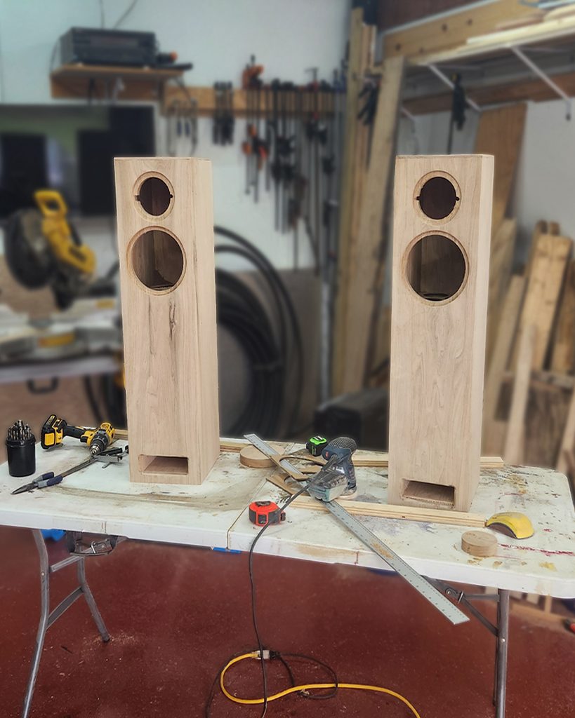

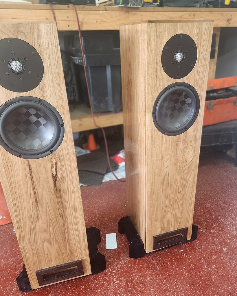

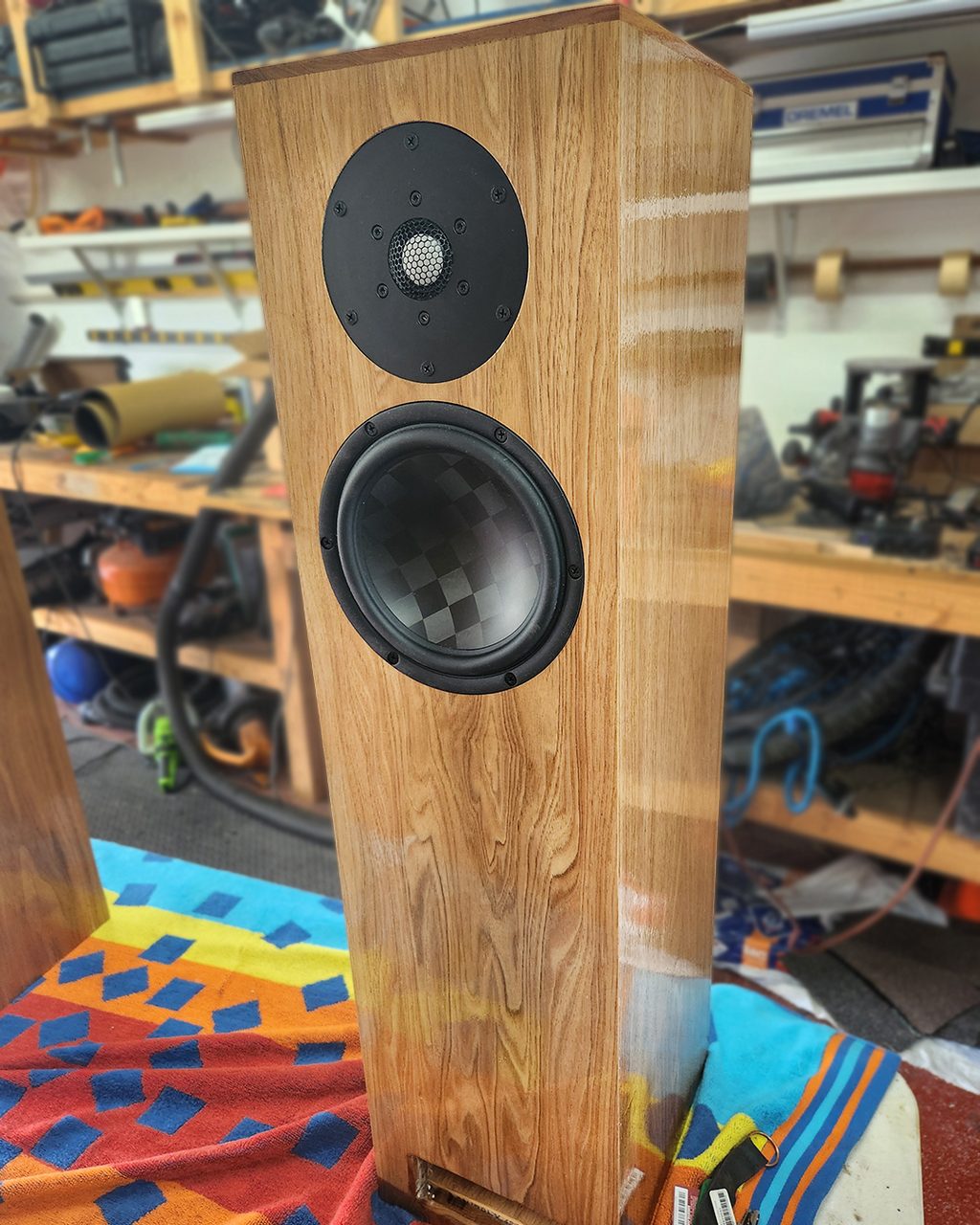

“Extremely Nutty” Tower Speakers, by Mike Weber
Project Level: Advanced
Project Time: 20+ Hours
Project Cost: Over $1,000
Project Description: 1″ thick butternut wood, 36″ tall, 12″ deep, 9″ wide, with a 6×2″ 9 inch long front port.
Design Goals:  Needed a short speaker that will be placed close to the wall.
Driver Selection:
-7.5″ Satori Ara TeXtreme by, SB Aacoustics
-1″ Epique EC30-4 tweeter by, Dayton Audio
Enclosure Assembly: We used a locking 45° miter joints.
Crossover Design: 2 way crossover at 1400 hz.
“My brother (who these were built for) always complained that I buy nice wood and then put a bunch of holes in it 😆 So for his speakers we wanted the beautiful wood to be the showcase while still having beautiful sound”
