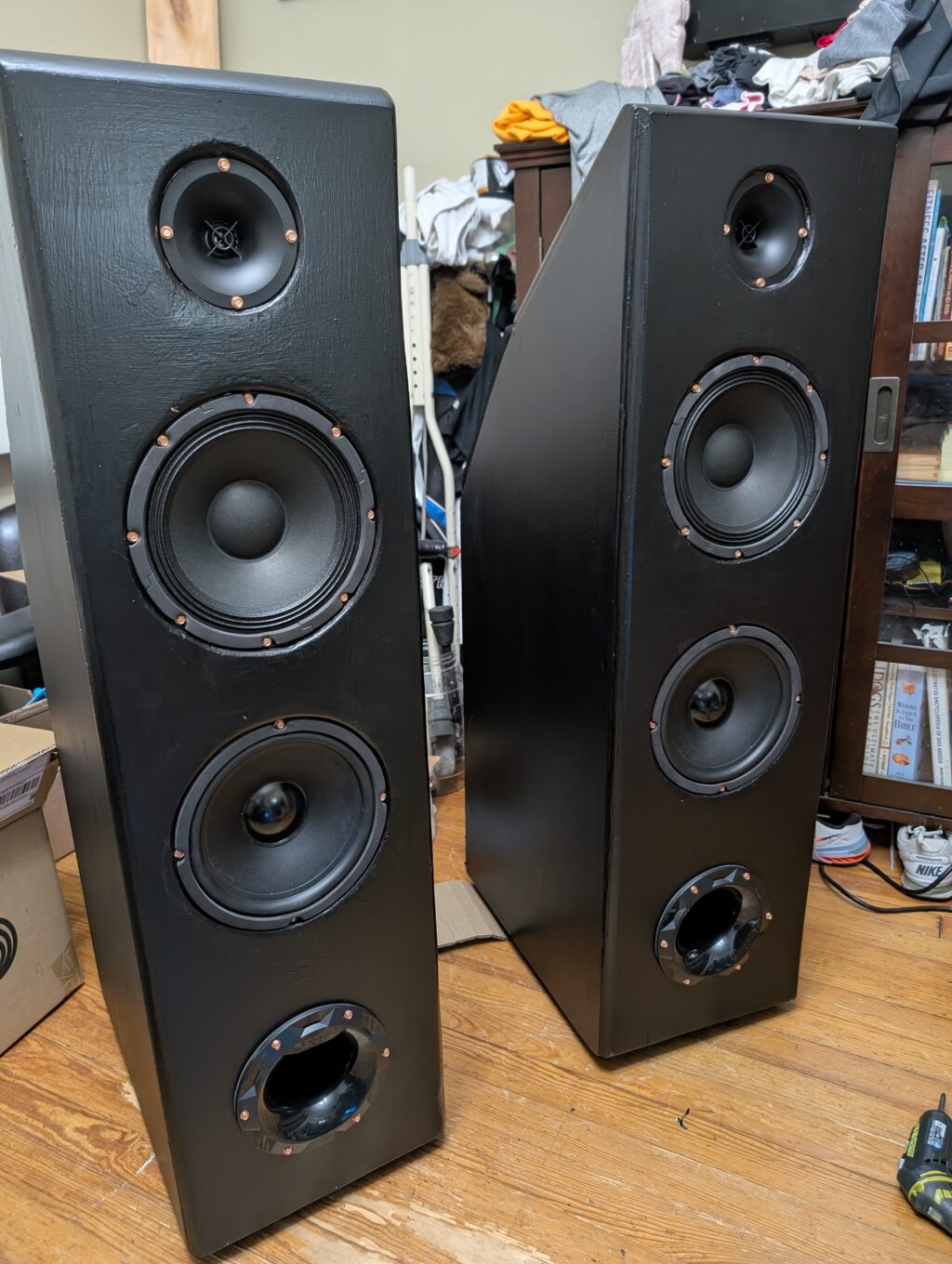

Project Description:
Set out to learn building a small bookshelf but it turned into a tower fast. Had few tools table saw, curricular saw, belt sander, screw gun, chalk gun. Did all the work from my wheelchair or crawling on the deck. Biggest challenge was managing the plywood on the table saw.
Design Goals:
Build a tower with some shape to it not just a box
Driver Selection:
Wanted a three way speaker but did not want to spend a ton.
– Peerless by Tymphany H25TG05-08 1″ Titanium Dome Tweeter with Waveguide 8 Ohm Part # 264-1381
– Dayton Audio MB820-8 8″ Professional High Power Midbass Driver 8 Ohm Part # 295-636
-Goldwood GW-8028 8″ Butyl Surround Woofer 8 Ohm Part # 290-355
Enclosure Design:
Used cardboard, a ruler and my head.
Enclosure Assembly:
3/4 plywood Burch Furniture grade.
Crossover Design:
Just started learning how to do crossovers now and my new build but for this I used Dayton Audio XO3W-700/5.6K 3-Way Speaker Crossover 700/5,600 Hz Part # 260-156. I can change this out when I learn more, I put the crossover in its own chamber that is easy to get to, you will see in the pictres.
